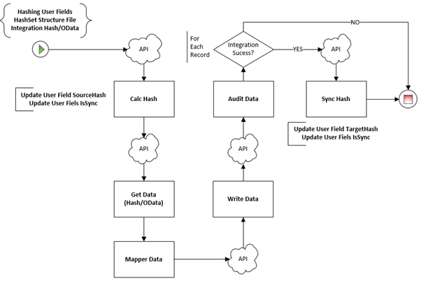

The VALUEKEEP V3 - Valuekeep Integrator plugin, provides in its installation folder: <Install Path> <VKKPlugin\SAMPLES\CONFIGS, an integration solution (VK3_V10_Integration.config), that can be reused as a base example, which can be customized according to the integration processes defined in the implementation scope. The specific example contextualizes an integration solution between VALUEKEEP V3 and PRIMAVERA ERP V10 systems.
The solution's configuration is defined in Integration.Config, a file containing the complete definition of the pipelines' execution context.
Conceptually, the solution provided as a base example gathers a set of example pipelines whose definition is based on the following structure.
