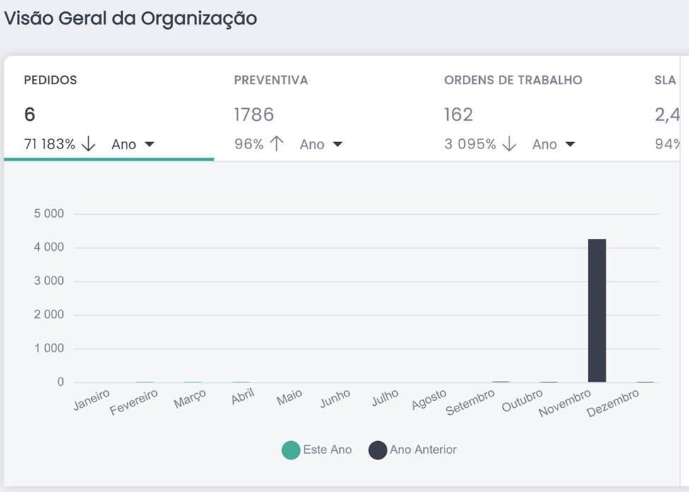

Overview Dashboard
This
dashboard presents the following set of graphs:
- Requests: presents
the number of requests the user created, in comparison with the homologous
period. This information can be grouped by: Year, State and Type. This
graph has a meter with the total number of requests for this year. It also
presents the homologous variation as a percentage. This value is calculated
using the difference between the requests the user created this year and
last year, dividing by the number of requests the user created this
year.
- Preventive: presents
the number of preventives the user created or from workshops he manages,
in comparison with the homologous period. This information can be grouped
by: Year and Execution. This graph has a meter with the total number of
preventive events of workshops he manages.
- Work
orders: presents the number of work orders the user
created and from workshops he manages, in comparison with the homologous
graph has a meter with this year's total number of work orders he created
or from workshops he manages. The homologous variation is calculated based on the
difference between the number of work orders from this year minus the work
orders the user created last year and from the workshops he manages,
dividing by the total number of work orders from this year the user
created and from the workshops he manages.
- SLA (Service
Level Agreement): presents the %
of SLA compliance, in comparison with the homologous period. This
information can be grouped by: Year and Type. The homologous variation is
calculated based on the difference between this year's total percentage of
SLA compliance minus the total percentage of SLA compliance from last
year.
- Average
response time: presents the average response time. This
information can be grouped by: Year and Type. The information on the graph
is presented in hours and compares the Average Approval Time, the Average
Opening Time and the Average Execution Time.
- Costs: presents
the costs. This information can be grouped by: Cost, Type and Year.
*The SLA indicator matches this year's SLA's global compliance
percentage and variation regarding the previous year (only for WOs).
It is worth mentioning that the value is cumulative, that is, it
includes the SLA calculation since the start of the year until that
month. The formula is: no. of WOs compliant with the SLA/total no. of
WOs.
A Work Order complies with the Service Level Agreement if
the end date is met and if it is previous to the expected end date. If the SLA
end date is not filled in, it is only compliant if it is previous to the
current date.
For this indicator, only the WOs with the SLA start date filled in and
that are not on the state "canceled" are considered.
**The approval time is the difference between the WO creation date and
the date of the first transition for a state that allows assignments.
The opening time is the difference between the date of the first
transition for a state that allows assignments and the date of the first
transition for a state that allows work reports.
The execution time is the difference between the date of the first
transition for a state that allows work reports and the WO SLA end date.

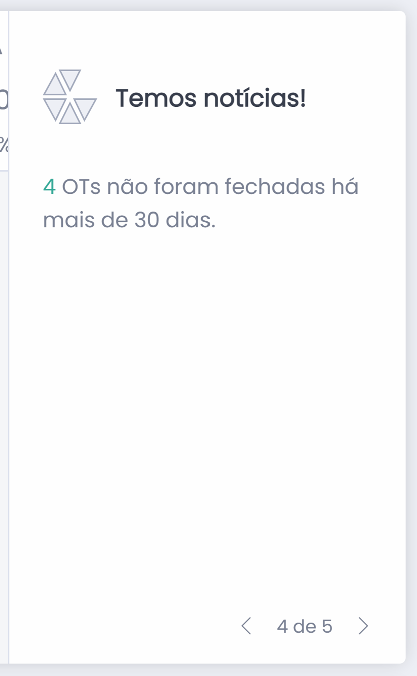

On
the same dashboard, the following insights are presented:
- Work
orders pending to close for more than 30
days; In here we include all work orders where the user is the workshop
manager and that are in a state previous to the final and not canceled
state for over 30 days.
- Equipment
unavailable for more than 7 days;
- Tools
- Locations
unavailable for more than 7 days.
In
each insight there is an indicator that will open a list with the detailed
information each when clicked on.

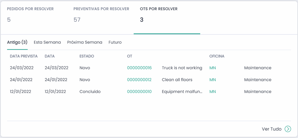

Operational Dashboard
The
operational dashboard presents a top five of the following lists:
- Unsolved
requests: presents a list of requests that are not on
the final state nor canceled;
- Unsolved
preventives: presents a list of preventive events
the user created or from the workshops he manages that still have no work
order created;
- Unsolved
work orders: presents a list of work orders the user
created or from the workshops he manages that are not on the final state
nor canceled;
The lists are groups in 4 temporal spaces:
- Old;
- This
Week;
- Next
Week;
- Future.
In
each one of the lists, there is the option "See all" that presents
the complete list.
