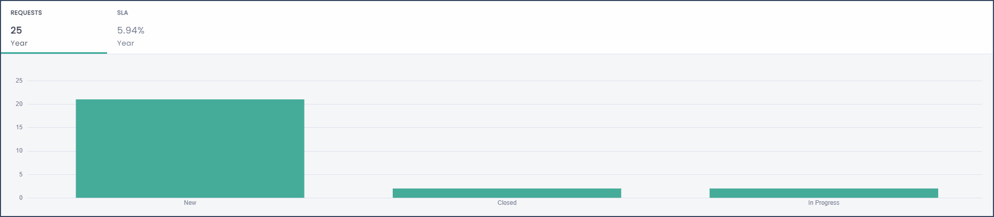

This dashboard presents a set of two graphs (Requests and SLA) and an Insight (requests pending to close for more than 7 days).
- Requests - shows the number
of requests created by the user and the asset requests on your access level,
grouped by state.This graph has an
indicator with the total number of requests.
- SLA - presents the % of SLA compliance. This
graph presents the number of requests that comply or not with the SLA
indicator.

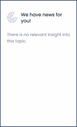

This Insight
specified that the number of requests are pending to close for more than 7
days.
Please note that
a request is considered pending to close when it is in a state previous to the
one considered as final.

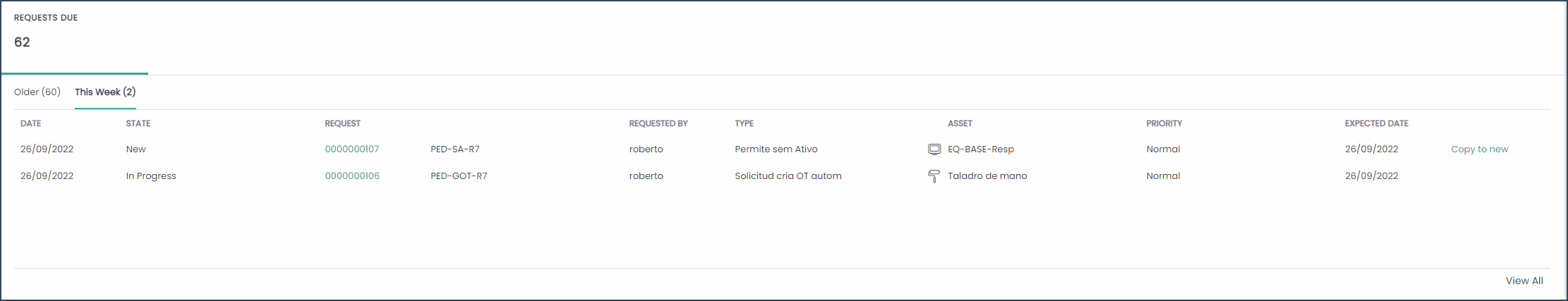

Operational DashboardThe operational dashboard
presents a top-five list of requests that are not on the final or canceled
state:
- Older – all requests up to the first day of the current
week;
- This Week – all requests regarding the current week;
