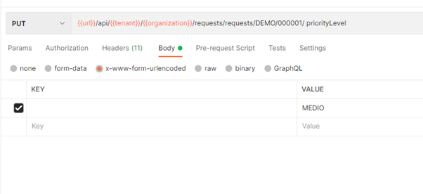

Body example to change the request attribute:
Select:
  1. x-www-form-urlencoded
  2. on the column VALUE, place the value of the attribute you wish to change.
Example: Changing the priority level of request 000001.
