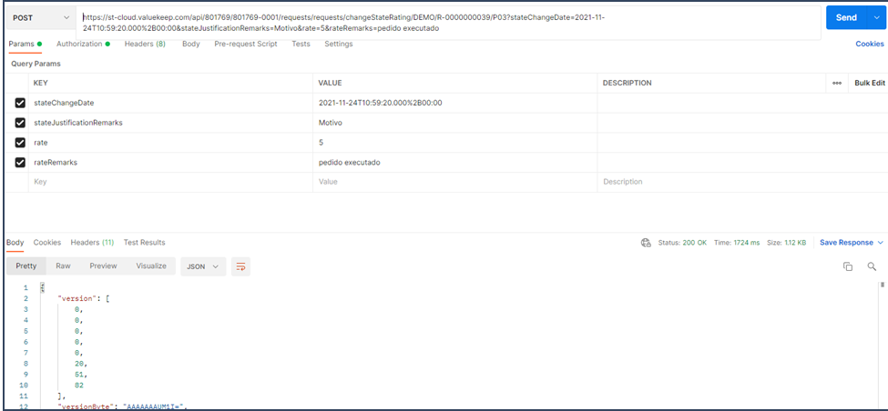

This method allows to change the request state and, if it is on the final state, it allows to classify the service.
The method to be used when changing the state of a request:
POST {{url}/api/{{tenant}}/{{organization}}/requests/requests/changeStateRating/{{companyKey}}/{{requestKey}}/{{schemaEntityStateKey}}
 On the API request, the following must be specified:
  1. companyKey: company key;
  2. requestKey: request key;
  3. schemaEntityStateKey: key of the state being changed.
 This method allows to change the request state according to the following parameters filled in:
  1. stateChangeDate: state change date. If not filled in, the current date will be used;
  2. stateJustificationRemarks: state change reason. This field can be mandatory, is the state transition requires it.
  3. rate: service classification number, integer between 1 and 5. This information is only saved if the request state being changed is setup as a final state and not as canceled;
  4. rateRemarks: service classification remarks, this information is only saved if the request state being changed is setup as a final state and not as.
When this method is executed successfully, it returns HttpStatusCode.OK with the state change information.
Example for the parameters on the method:
 POST {{url}/api/{{tenant}}/{{organization}}/requests/requests/changeStateRating/{{companyKey}}/{{requestKey}}/{{schemaEntityStateKey}}?stateChangeDate=2021-11-24T10:59:20.000%2B00:00&stateJustificationRemarks=Motivo&rate=5&rateRemarks=pedido executado
