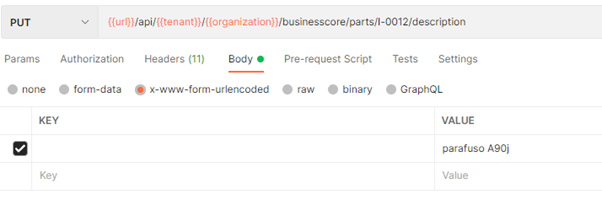

Body
example to change the part/service attribute
Select:
- x-www-form-urlencoded
- on
the column VALUE, place the value of the attribute you wish to change.
Example:
Changing the description of the part I-0012.
When
this method is executed successfully, it returns HttpStatusCode.200 OK
