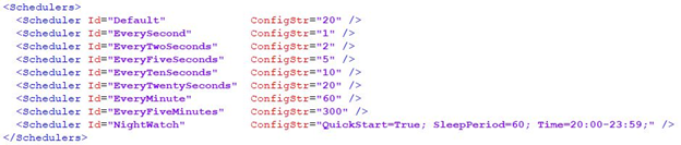

The execution frequency for a pipeline is defined using the scheduler on the pipeline configuration. The Schedulers catalog, present on the solution made available as a base example, can be customized by including new items, by using the utility Valuekeep Integrator SDK.
The definition of an Scheduller is synthesized in the definition of two attributes:
·      Id: identification or designation of the scheduler;
·      ConfigStr: configuration string that represents the execution frequency, obtained by using the utility or written in seconds.
