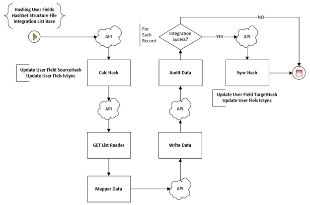

The PRIMAVERA V10 – Valuekeep Integration plugin, offers in its installatio n folder: <Install Path>\VKPlugin\SAMPLES\CONFIGS, an example of a solution that can be reused as a base example, and that can be customized according to the integration processes defined in the implementation.
The solution configuration is defined in the Integration.Config, file with the complete definition of the pipeline execution context.
Conceptually, the solution made available as a base example gathers a set of pipeline examples, whose definition is based on the following structure.
