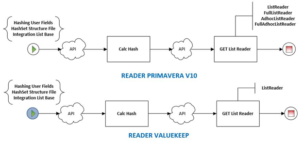

The readers available on the PRIMAVERA V10 – Valuekeep Integration plugin has the goal of providing the systems (PRIMAVERA ERP V10 and Valuekeep) with mechanisms that reduce the number of requests and allow the implementer/integrator to easily customize the reading requests according to the requested business processes.
The goal of the reader is to identify on the source system, the information subset that requires integration with the target system, preserving service performance issues. For that reason, to improve these principles, the following methodology has been adopted:
  1. Hashing System : the information subset is controlled by a hashing technique applied on the source system (you can view more information on this technique on the article:  Pipelines – Hashing ):
  2. Applicational Lists : the information subset result is obtained using the applicational lists, available in both systems (you can view more information on this procedure on the article:  Pipelines – Lists ).
The following image shows the technique applicable on the plugin to get the information that will be integrated.
