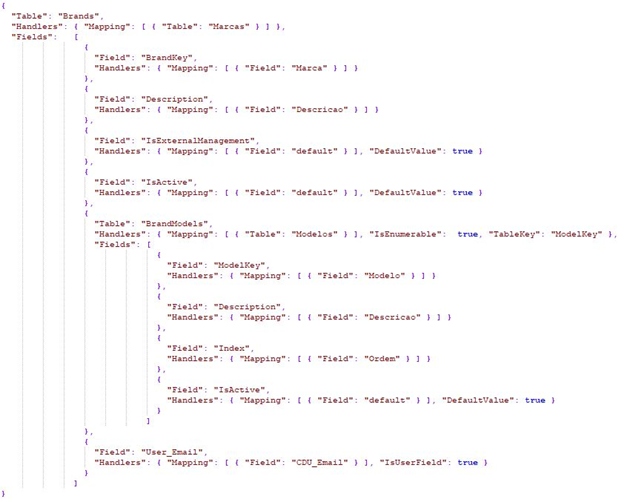

  1. A service integration solution must be able to easily define data bidirectional transformations, from their native representation to other formats, more adequate for the process integration, such as: XML, JSON.
  2. The PRIMAVERA V10 – Valuekeep Integration plugin, offers a transformation process (format JSON) with the purpose of mapping the data from the source system to be issued to the target system. This mapping technique uses a Data Dictionary, preserving the original data and the transformed data.
  3. In order to optimize the integration processes, the plugin offers on the installation folder – <InstallPath>\VKPlugin\SAMPLES\MAPPERS – a set of mappers (json files) that can be used when implementing the integration services.
  4. The syntax and semantics applied is common to both systems and is defined in a model context and easy to interpret.
