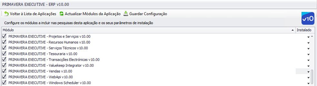

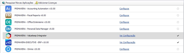

  1. Application/platform Valuekeep Integrator configuration:
  2. Module Valuekeep Integrator configuration, available on the application Valuekeep Integrator (we recommend that the installation folder matches the solution installation folder Valuekeep):
  3. Applicational module Valuekeep Integrator, available on the application PRIMAVERA ERP V10:
  4. Installation of the modules configured on the previous items.
