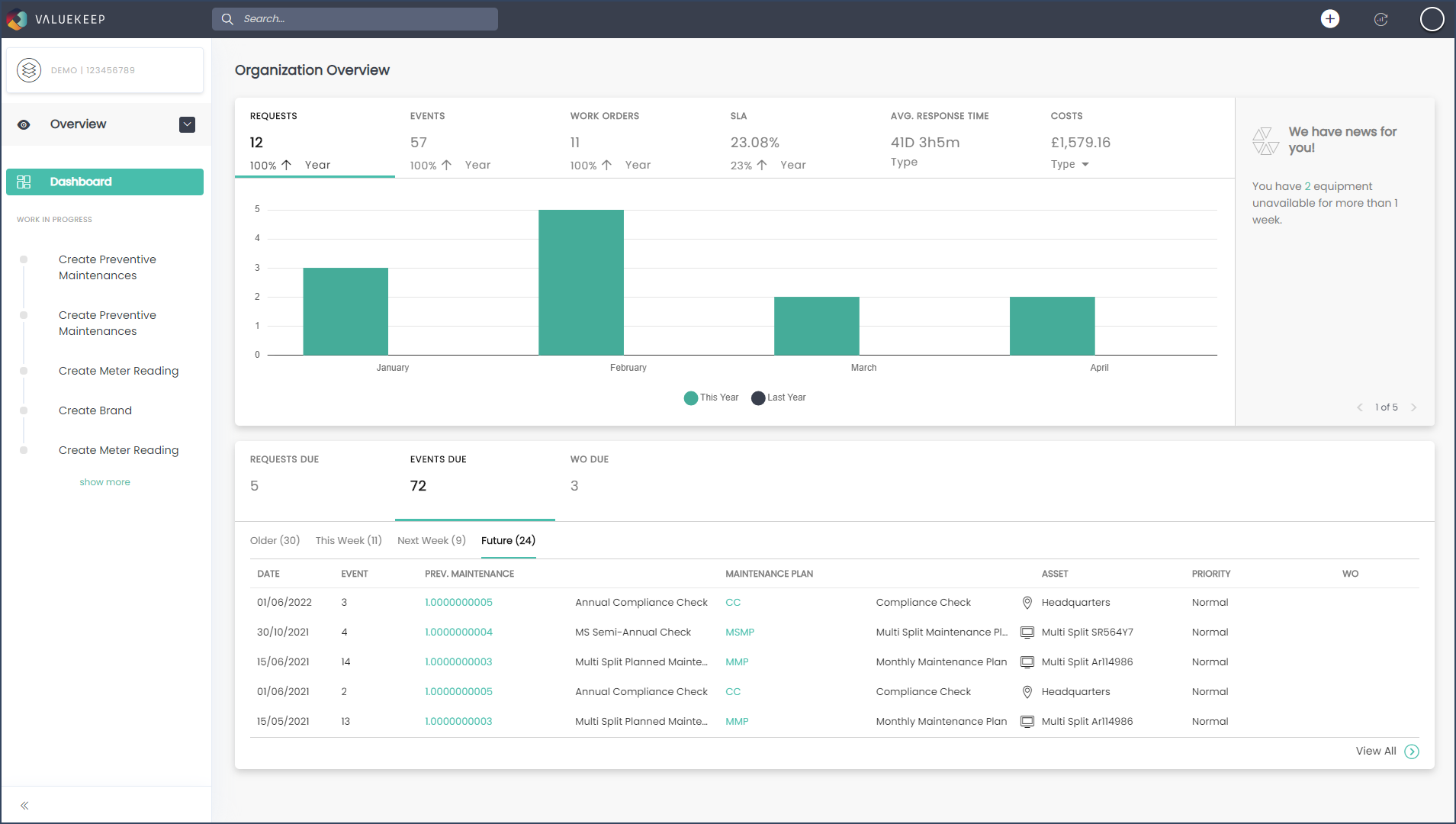

Dashboard
The information available in this area varies depending on the user profile being used. Here the different operational or management dashboards can be consulted.
In this case, you can see the number of requests and events for the current year, such as work orders, Service Level Agreement (SLA) and costs, and you can compare these figures with the previous year's data.
Below you can see the unresolved requests, events and work orders.

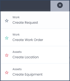

Quick Actions
To optimize repetitive operations and increase the fluidity of processes, you can find an option for quick actions on the interface.

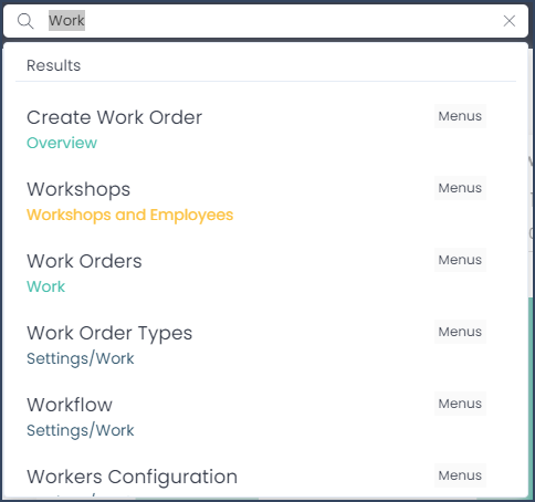

Search
If you cannot find what you are looking for, you can use the Search bar, which will show you results related to the keyword you type.

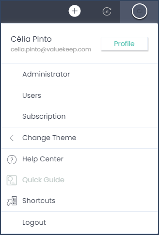

Personal Area
All users can access a set of options related to their profile through their personal area. Here it is possible to see the users of each subscription, access the profile type's own settings, change the theme and access the Help Center and Quick Guide.

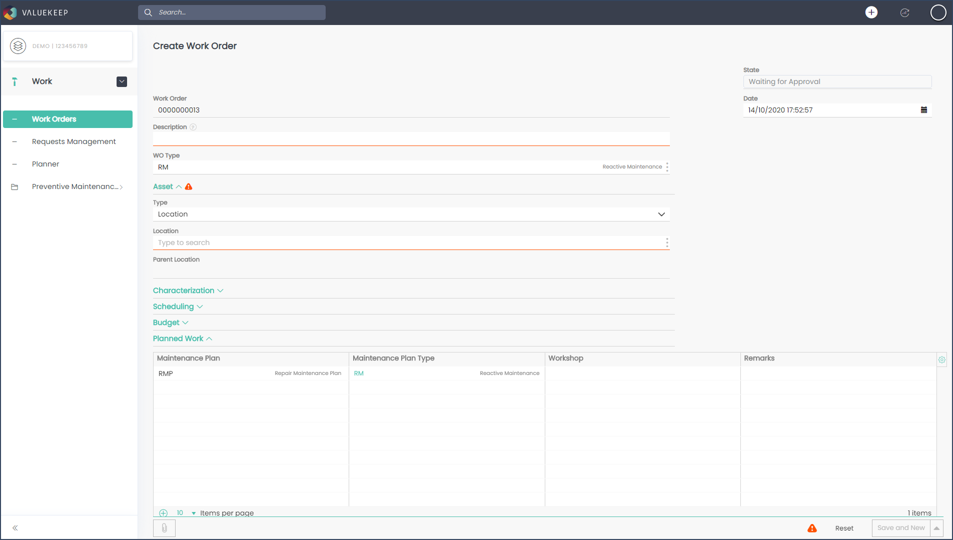

How do I create a new report?
- You must access the desired list. For example Work > Work Orders.
- To create a new report, simply press the Create button in the lower right corner, thus opening a new report screen.
- Throughout the screen you can find different icons that can help you fill in the desired fields. The button with the question mark gives you information about the field to be described and the triangle button tells you which mandatory fields are missing.
- If you want to add attachments to the report, simply select the clip-shaped button in the lower left corner.
- Clicking the Reset button returns all settings to their original state as it was when you opened the scree
After filling out the fields, you have two options:
- Save and New - saves the report and the screen is cleared to create a new report.
- Save - saves the report and enters the view mode.

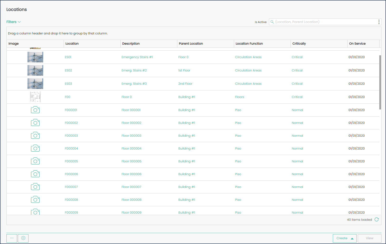

What are lists?
In the Valuekeep CMMS interface we can find different lists, such as locations and equipment or employees and warehouses, among others.
In these lists you can perform a set of operations:
- Search by the content of the different columns
- Group columns
- Sort by column, just click on the column you want (e.g. Location)
- See more details of the list elements that are in green, just click on the desired option (e.g. AM)
- Add new columns by clicking on the Gear button
- Export the list itself to .csv or print it by clicking the Three dots
- Create a new report by pressing the Create button in the bottom right corner.
- View the report details by selecting the report in question and pressing the View button in the bottom right corner.
