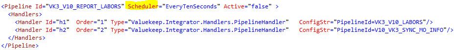

The frequency of execution of a pipeline is defined
through the scheduler expressed in the configuration of the pipeline. The
Schedulers catalog present in the solution available as a base example can be
customized with the inclusion of new items, using the Valuekeep Integrator SDK.
The definition of a Scheduller is synthesized in
the definition of two attributes:
The Valuekeep
API should only be consulted for a minimum of 5 min (300 seconds). Any
scheduler identified above serves merely as an example.
