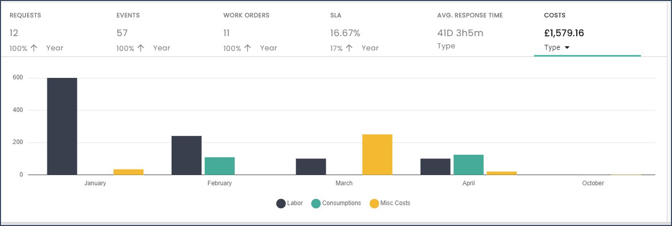

- Management indicators with the corresponding graphics:
- Requests - total number of requests created on the current year is presented (except canceled);
- Year - total number of requests per month vs. previous period.
- State - total number of requests per state.
- Type - total number of requests per request type.
- Preventive - total number of preventive maintenance events expected for the current year is presented;
- Year - total number of preventives per month vs. previous period.
- Execution - number of preventives Planned vs. Executed, per month. Previously, we present the execution percentage.The % of execution is calculated as follows: (total number of events executed/total number of events (annual))*100.
- Work Orders - total number of work orders for the current year (the canceled WOs are not included);
- Year - total number of work orders per month vs. previous period.
- State - total number of work orders per state.
- Type - total number of work orders per work orders type.
- Service Level Agreement (SLA)* - % SLA compliance of the current year;
- Year - percentage of work orders compliant with the SLA per month vs. previous period.
- Type - percentage of work orders compliant with the SLA per work order type vs. previous period.
- Average Response Time** - average response times to the Work Orders on the current year;
- Year - average response times in hours per period of the current year;
- Type - average response times in hours per period of the current year per work order type;
- Costs - total number of costs for the current year (includes labor costs, material consumption and misc. costs.);
- Cost - total de costs per period of the current year per cost type;
- Type - total costs per work order type of the current year vs. previous year;
- Year - total costs per current year vs. previous year;

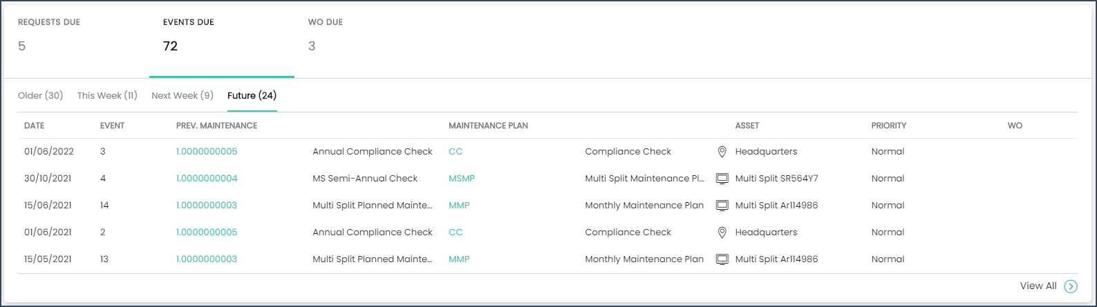

Operational Dashboard
The operational dashboard displays various data such as:
- Requests Due - total number of requests in a state other than "final" or "cancelled" without an associated Work Order.
- Events Due - total number of preventive maintenance events without an associated Work Order.
- WOs Due - the total number of WOs that are unassigned and not yet completed or cancelled.
Each of the above is divided into 4 sections:
- Older - corresponds to all records until the beginning of the current week;
- This Week - corresponds to all records of this week;
- Next Week - corresponds to all the records of the next week;
- Future - corresponds to all records to follow next week.
The filter used to match each record with its corresponding field is the Expected Date filter.´
